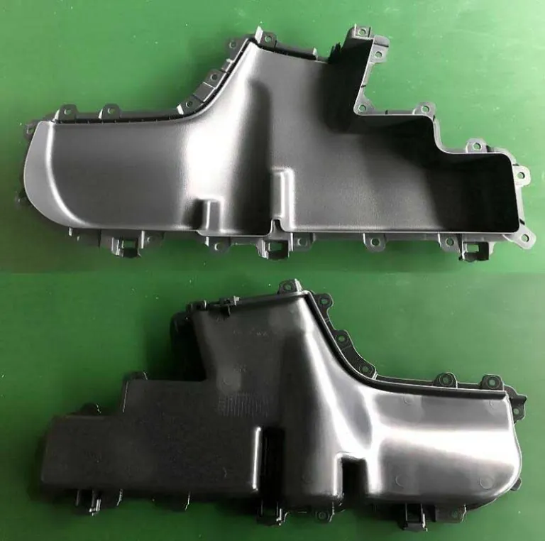

| B-pillar lower trims | SM2200-TP | PP + 20% talc | 822 g | Dimensional accuracy with minimal distortion across a left and right pair |

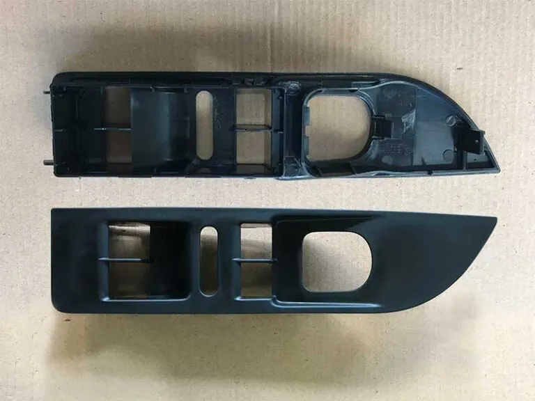

| Door component | SM850-TP | PC + ABS | 462 g | Complex shape, no surface scratching, stable weight, no short shots or deformation |
