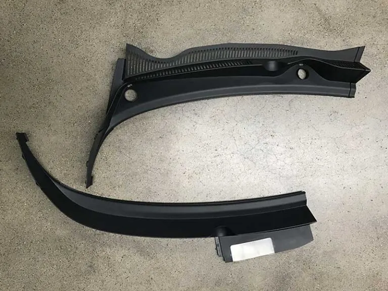

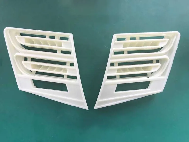

Pillars, bumpers, grilles and center console
  • Single-component molding
  • Multi-component available

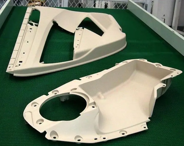

Door panels, door substrates and battery housings
  • Chemical foaming and compression molding
  • Continuous fiber thermo-compression molding

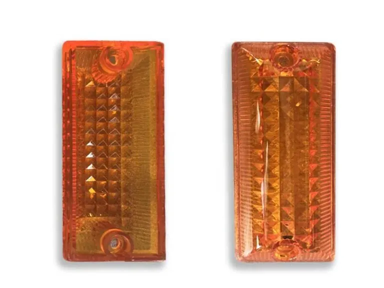

Headlights and lenses
  • Single-component, opposing injection or rotary table
  • Multi-component, opposing injection or rotary table

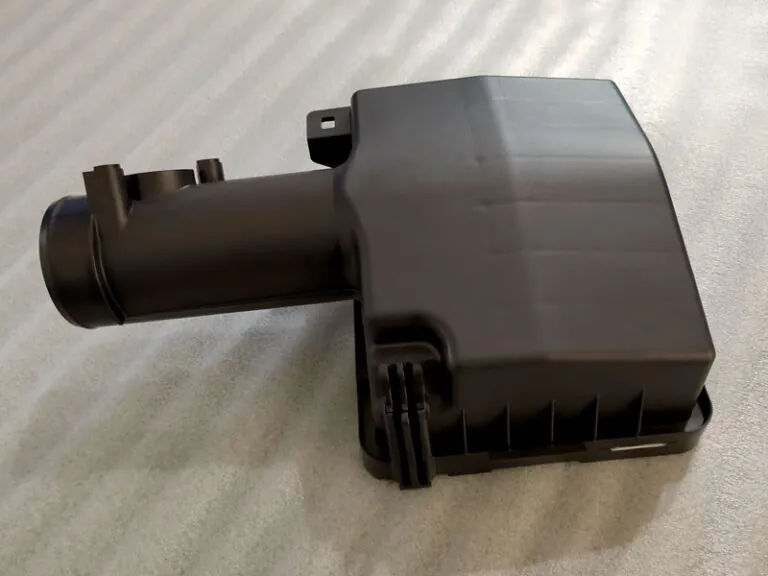

Hoods and tubing parts
  • Physical foaming
  • Gas-assisted and water-assisted injection molding

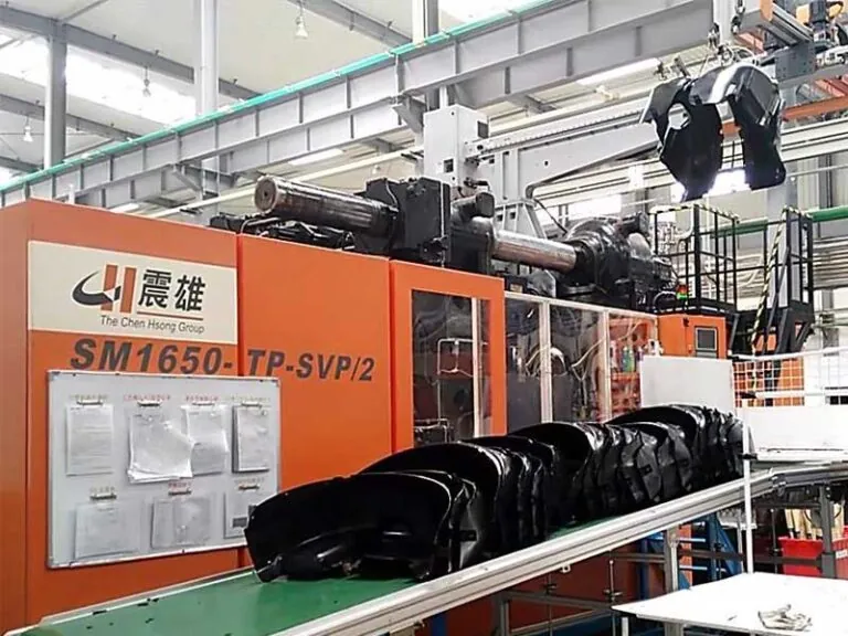

Large parts
Bumpers, tailgates, instrument panel carriers
A bumper tool is close to two metres wide and deep enough to need a long opening stroke, and the platens have to stay parallel under full clamp or the flash lands on the visible edge.
A two-platen machine clamps directly on the tie bars, so it gives that platen rigidity in a footprint shorter than a toggle of the same tonnage, with the daylight and mold height a deep tool needs.
  • Platen parallelism under full clamp, large daylight and mold height, ±0.2 percent shot-to-shot repeatability, 550 to 6,500 tonnes across the two series.

Appearance parts
Door trims, consoles, grilles, pillar trims
Interior and exterior trim is accepted or rejected on its surface: sink over ribs, flow marks, gloss variation and, for interiors, the VOC limit in the material specification.
The machine has to hold packing pressure the same on every shot and run the processes that these parts increasingly assume, such as physical foaming, IMD/IML and low-pressure lamination.
  • Consistent packing pressure, process interfaces for foaming and in-mold decoration, servo-hydraulic or hybrid drive.

Optical and multi-material parts
Lenses, light guides, lamp bars, two-shot trims

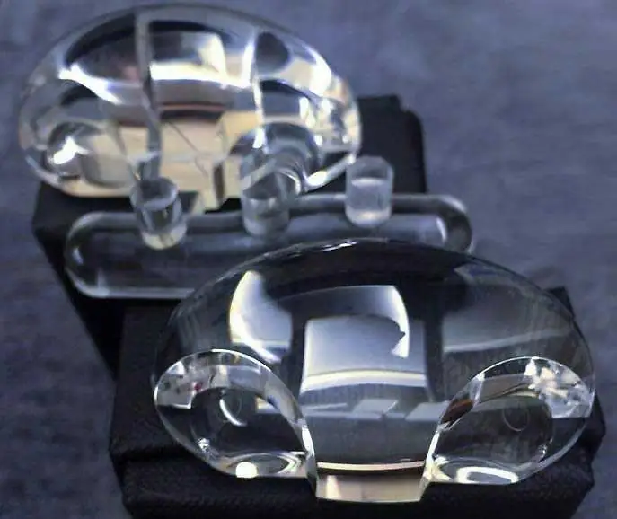

A lens is measured on light transmittance and internal stress, and both are set in packing and cooling. That needs electric injection that repeats the packing profile shot after shot, no hydraulic oil near the optical surface, and injection-compression for thick lenses.
Light guides in housings and two-colour lamp bars add a second material in the same cycle.
  • Electric injection, injection-compression, oil-free production area, multi-component capability for two-shot parts.

Front bumperSM3600-TPPP3.2 kgComplex geometry, weathering resistance, high impact strength, stable weight and dimensions

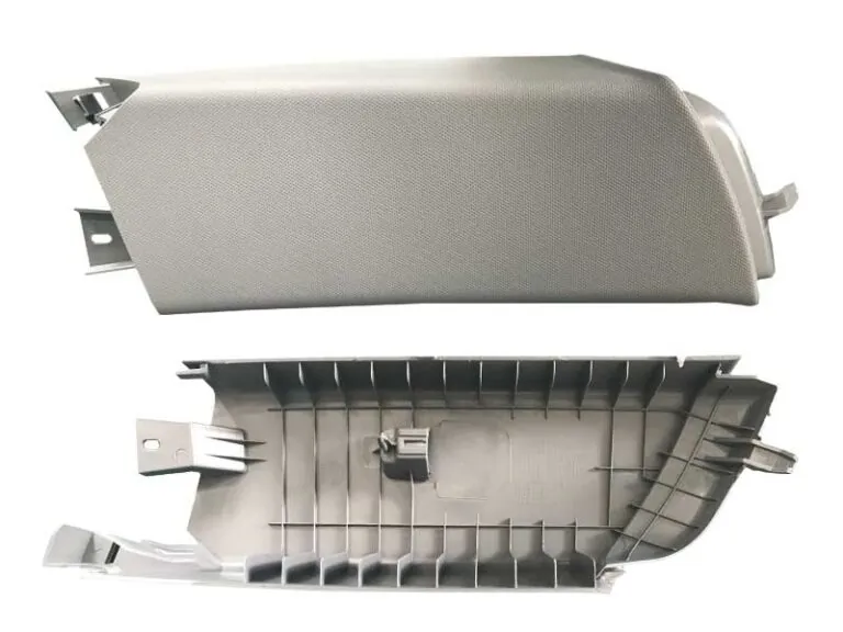

B-pillar lower trimsSM2200-TPPP + 20% talc822 gDimensional accuracy with minimal distortion across a left and right pair
Laminated interior panelSM1050-TPPP885 gEven stress and accurate shot volume, so melt flow does not deform the skin; low-pressure injection
Door componentSM850-TPPC + ABS462 gComplex shape, no surface scratching, stable weight, no short shots or deformation
Lamp lensJM258-MK6 PROPMMA50 gHigh light transmittance and heat resistance together with a lighter part

01What clamping force does a car bumper need?
Bumpers and grilles sit in the TP700 to TP4000 band, and a full front bumper is usually molded between 2,500 and 4,000 tonnes depending on projected area, wall thickness and resin.
One of the bumper applications on this page runs on a 3,600-tonne two-platen machine at a 3.2 kg shot weight. Please send us the part drawing and the resin data sheet and we will confirm the force and the mold space required
A two-platen machine carries a large, deep mold in a shorter footprint than a toggle machine of the same force, spreads the clamping load evenly across the platen face, and gives more daylight relative to machine size.

Yes. Lamp assemblies are molded on the DM III and DMZ III multi-material platforms, which use a rotary platen or opposing injection units to combine a clear lens with a coloured housing in one cycle.
Rotary platen positioning accuracy is the specification to check, because it decides whether the bond line comes out clean.
Gas-assisted molding using nitrogen costs less and suits handles, conduits and parts with large wall thickness differences, but it becomes difficult above roughly 40 mm diameter.
Water-assisted molding produces longer cavities, thinner walls and a smoother inner surface and cools faster, though PS and PC are not suitable and there is a real risk of leakage if the sealing is not right. We would suggest deciding on the inner surface requirement first.
