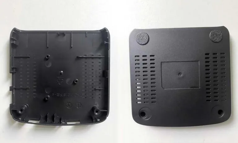

Injection Molding of ABS Router Enclosures with the MK6 Series
Router Enclosures A well known manufacturer located in Shenzhen, Guangdong Province, has been running over 20 of chenhsong JM168 Mk6 plastic injection molding machines to produce various injection molded parts for the consumer and electronics industry since 2016. The Mk6 injection machine features product repeatability of up to ± 0.25% with the latest technology in […]

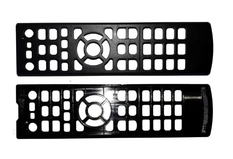

High Speed Toggle Injection Molding Of Remote Control Cases
Remote Control Enclosures Featuring Precision Hydraulics, since 2016 more than 20 of our JM168-MK6 High-Speed Toggle Type Injection Molding machines have been operating consistently with a cycle time of only 26s in fully automatic mode for a customer in Shenzhen, Guangdong Province, China, to manufacture remote control cases in 4 cavities in ABS. Each item […]

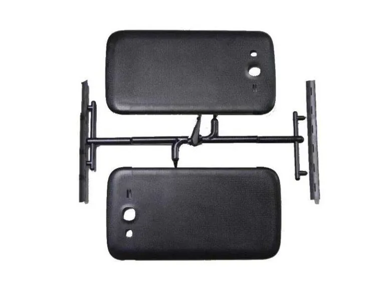

PC and ABS Injection Molding of Smartphone Covers
Smartphone Back Covers Smartphone manufacturers demand the finest qualities of finish and this requires excellent process control. For this application, our JM168-MK6 High-Speed Toggle Type Injection Molding machine, driven by the Servo Drive and controlled by the CPC 6.0 is a tried-and-tested choice for our customers, one of whom has been continuously manufacturing smart phone […]

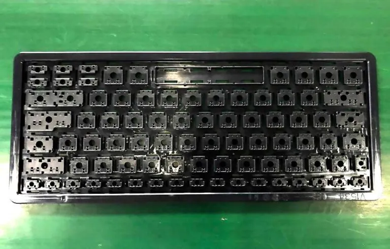

PC Keyboard Bases Manufactured in ABS Using the JM168-MK6 Injection Molding Machine
PC Keyboard Bases In Chongqing City, China, a customer has been using 16 Machines since 2017 to manufacture ABS keyboard bases with a shot weight of 60g and thickness of 1.5mm on a cycle time of 24s in fully automatic mode. For this application, a JM168-MK6 High-Speed Toggle Injection Molding Machine was an excellent choice, […]

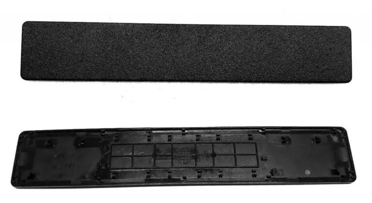

Injection molding of household components, light box end cover for the automotive industry
Light Box Back Covers Speed, efficiency, and quality; all these are attained with the MK6e plastic injection molding machine. With speed controlled servomotor, drives a fixed internal gear pump. The system pressure is measured real-time by a pressure sensor. In this way it can provide the required flow according the requirement to eliminate non-functioning consumption. […]
