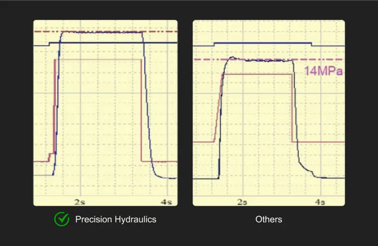

01. Smooth as Silk
Japanese hydraulic experts mapped the full circuit in simulation and eliminated unnecessary pressure drops through multiple rounds of optimisation.
A patented pressure-relief method releases pressure quickly without reversing the pump, cutting transient shock and component wear.
  • Pressure rises to target without overshoot, even at maximum injection speed
  • Clean, accurate V/P switchover instead of the slow, soft response of a standard circui

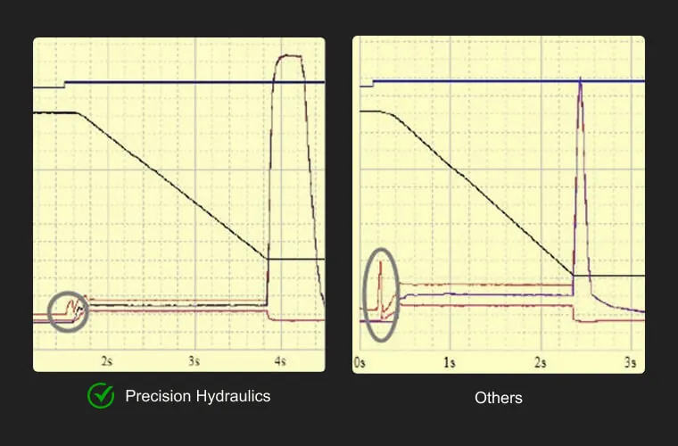

02. Rock-Solid Stable
Closed-loop control holds position, speed, pressure, and temperature to the programmed profile.
The servo drive responds on demand and rests during cooling, saving up to 80% energy compared with older fixed-pump hydraulic machines.
  • Holding pressure stays flat through the full packing phase, with no jitter or drift
  • ±0.05% repeatability on the MK6 main motion axes

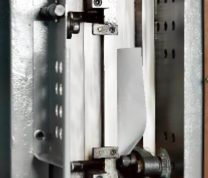

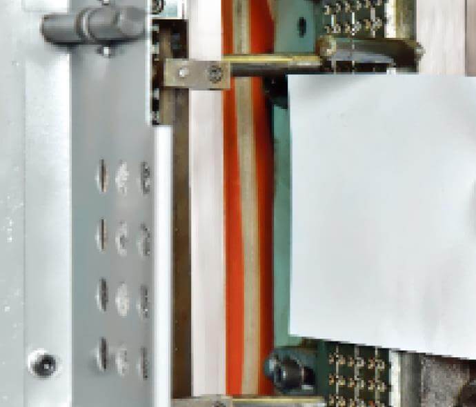

03. AIR Buffer™ Mold Protection
Three things working together give AIR Buffer™ its sensitivity: high hydraulic precision, optimised mechanical design, and patented control algorithms.
A precision pressure sensor reads through the servo system and detects an obstacle as thin as 0.1 mm during top-speed clamp closing.
Try it.
Put a sheet of normal A4 paper between the mold of a JM168-MK6 running at 100% speed and 100% pressure. The machine detects it, stops, and reopens. The paper comes out flat, not even punctured.
