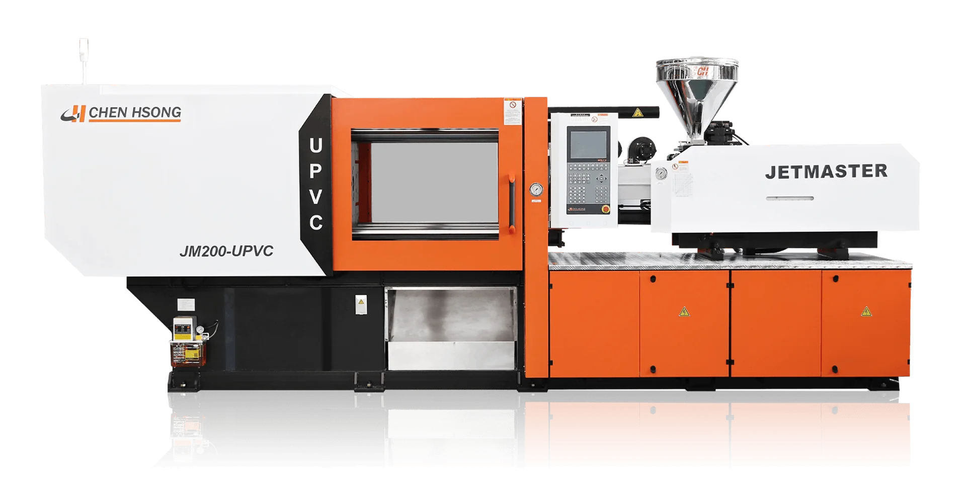

UPVC resins are corrosive, temperature-sensitive, standard equipment often faces severe operational limitations. The JETMASTER-UPVC is a dedicated UPVC injection molding machine built from the ground up to handle them. Specialty bi-metallic anti-corrosive screw and barrel, a fan-cooled barrel with convection cooling tunnels, and an interior-plated anti-corrosive nozzle. Every component exposed to UPVC is optimized to ensure maximum machine life and reduce your total cost of ownership.
160 to 650 tonnes, 2 sets of core pulls as standard, extra-wide doors sized for pipe fitting molds, stainless steel hopper and chute, and servo-hydraulic drive. A pipe fitting injection molding machine ready for production from day one.

The JETMASTER-UPVC is a dedicated UPVC injection molding machine engineered from the ground up for chlorine-containing resins: anti-corrosive nozzle with interior plating, stainless steel hopper and chute, fan-cooled barrel for precise temperature control, corrosion-resistant coatings throughout, and extra-wide doors designed for pipe fitting molds.

The JETMASTER-UPVC injection molding machine is available from 160 to 650 tonnes (JM160 through JM650).
