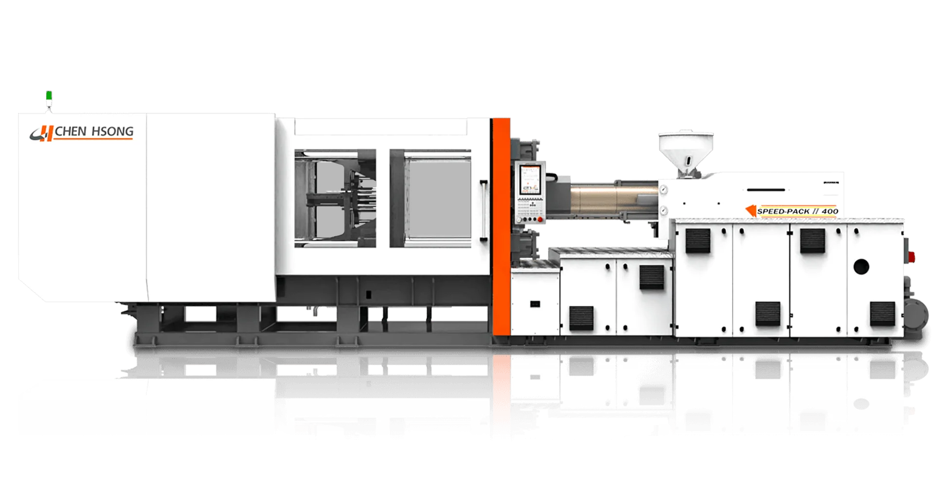

The SPEED-PACK II is the flagship of Chen Hsong’s high-speed packaging series, purpose-built for thin-wall production. Precision Hydraulics technology, developed with Japanese hydraulic expertise, delivers silky-smooth mechanical motion at up to 500 mm/s injection speed with sub-millimeter accuracy and dry cycles as short as 1.5 seconds. A packaging-specific plasticising unit with specialty screw design sustains high melt throughput at quality, so the machine keeps filling thin-wall cavities completely, cycle after cycle.
Built to hold that speed in 24/7 production. The machine base is 50% more rigid than industry standard for stability at full injection speed, thickened platens with optimised stress distribution keep clamping force even to prevent flash, and Precision Hydraulics keeps motion smooth and repeatable where general-purpose machines drift. Well suited for thin-wall food containers, dairy and ice-cream packaging, caps, closures, and IML (in-mold labeling) production where consistent cycle times and low scrap rates drive profitability.

The SPEED-PACK II (260–570T) is the flagship, purpose-built for thin-wall packaging with a packaging-specific plasticising unit, up to 500 mm/s injection, and dry cycles as short as 1.5 seconds.
