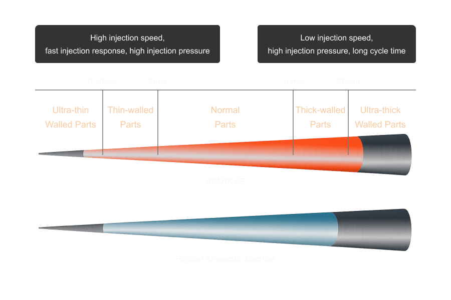

03. AA: All-Adapt™
Different plastics behave differently. PP flows easily; polycarbonate is highly viscous. A thin food container and a thick automotive housing need completely different pressure profiles. On most machines, the operator adjusts manually for each job.
All-Adapt™ handles this automatically. The control algorithm identifies the material and wall-thickness profile, then shifts the machine’s performance to match. One machine covers ultra-thin-wall (0.25 mm) to ultra-thick-wall (20 mm) without manual retuning, with strict overflow prevention throughout.
  • 0.25 mm to 20 mm wall thickness on a single machine
  • Automatic pressure-profile adjustment for different materials and parts
  • Strict overflow prevention across the full range
