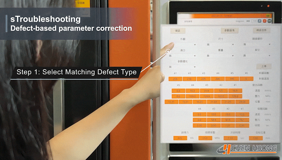

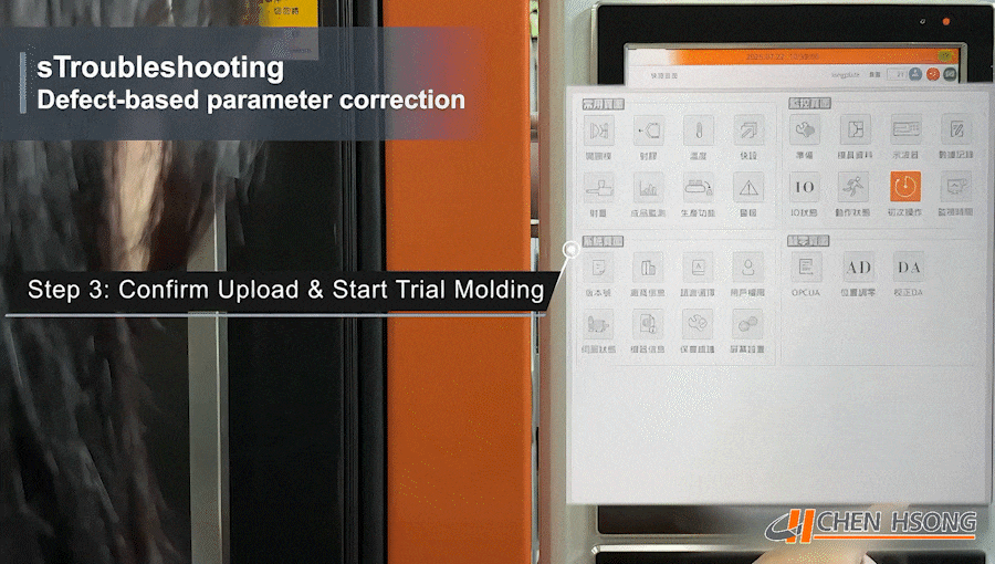

sTroubleshooting - Smart Defect Diagnosis
See a defect. Select it. Get corrective parameters in seconds.
iChen™ AI Molder’s sTroubleshooting module draws on a knowledge base of over 2,000 real-world defect cases, built from Chen Hsong’s decades of injection molding production expertise. When an operator identifies a defect, they select the defect type from the system
interface.
Within seconds, AI Molder analyzes the root cause and recommends specific parameter adjustments to resolve the issue. Self-learning system improves with usage.
  • 2,000+ real-world defect cases in the knowledge base
  • Response in seconds, 90% accuracy
  • Self-learning system improves with usage
