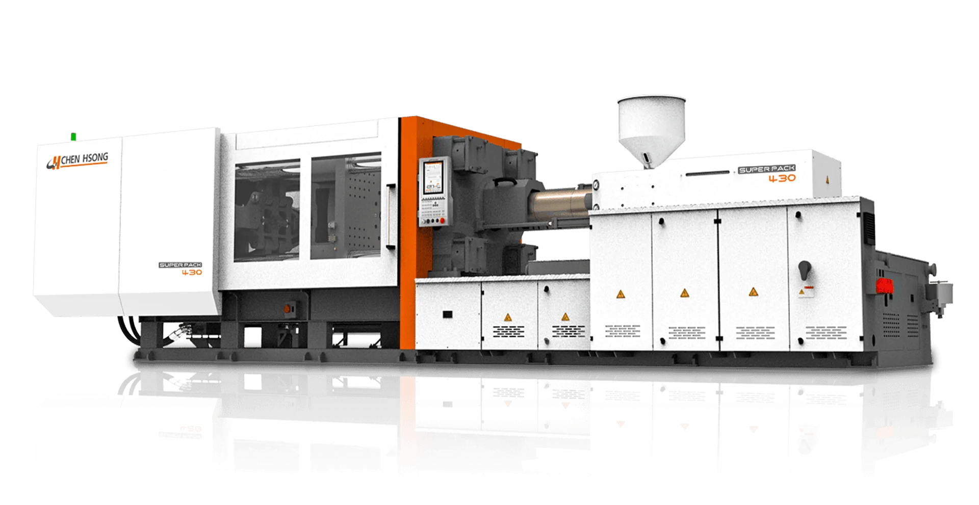

Chen Hsong SUPER PACK high-speed packaging injection molding machine-01
SUPER PACK
270 -
430 T
SUPER PACK
Maximum Output. Maximum Consistency.
The SUPER PACK is Chen Hsong’s top-tier high-speed packaging machine, built for the highest output rates in thin-wall production. Accumulator injection delivers the fastest fill rates for demanding thin-wall and large-part packaging. Precision Hydraulics technology, developed with Japanese hydraulic expertise, ensures silky-smooth motion and sub-millimeter precision at every cycle. 51% higher plasticising rate than standard machines for the shortest recovery times.
29% larger power pack than industry standard for consistent high-pressure injection and easy setup of any application. Machine base rigidity 50% above industry standard. No-weld piping and flanges eliminate oil leaks for reliable 24/7 operation. Thickened platens with centralised clamping force distribution for zero flash on high-cavitation molds. Built for food containers, pails, biodegradable tableware, and high-volume thin-wall production at scale.
