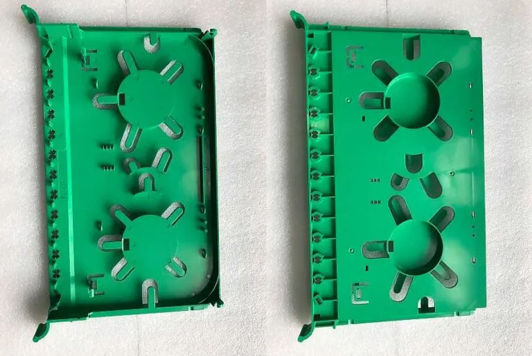

Injection molding Fiber Optic Fastners with The EM80-SVP/2 IMM
Fibre Optic Fasteners A customer in Hubei Province, China, is using 6 EM80-SVP/2 Injection Molding Machines to manufacture fiber optic fasteners in ABS and polycarbonate (PC). In operation since 2012 and operating in semi-automatic mode, the EM80-SVP/2 Injection Molding Machine is driven by an SVP/2 Servo Drive with a clamping force of 80 tons controlled […]

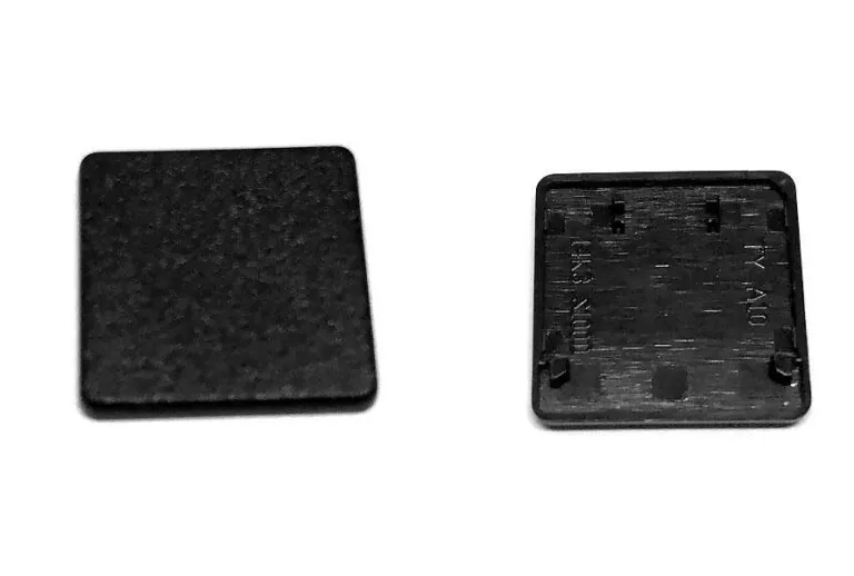

Manufacture of Small Keyboard Key Caps with the JM98-Ai Injection Molding Machine
Keyboard Key Caps (Small) In Chongqing City, China, a customer is manufacturing ABS small key caps for computer keyboards using 16 of our JM98-Ai Toggle Type Injection Molding Machines. In operation since 2015, the JM98-Ai Injection Molding Machines deliver a clamping force of 98 tons from an SVP/2 Servo Drive managed by a Nippobatta Ai-02 […]

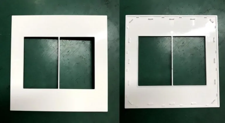

Manufacture of Legrand Electric Wall Plates Using the EM220-SVP/2 Injection Molding Machine
Legrand Electric Wall Plates The Toggle Type EM220-SVP/2 Injection Molding Machines our customer in Beijing City, China, uses to manufacture this prestigious branded part out of poly carbonate resin delivers a clamping force of 220 tons with an SVP/2 Servo-Drive controlled by the Nippobatta Ai-02 unit. With 20 Machines operating in fully automatic mode since […]

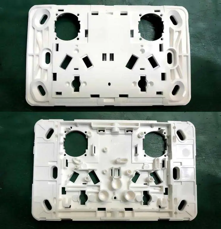

Injection Molding of Legrand Wall Switch Covers with the JM98-Ai Injection Molding Machine
Legrand Wall Switch Covers One of our customers in Beijing City, China, has been employing 20 of our JM98-Ai Injection Molding Machines to manufacture wall switch covers for this premier international brand since 2011. Applying a clamping force of 98 tons, driven by the VDP power pack with Nippobatta Ai-01 controller, the JM98-Ai Injection Molding […]

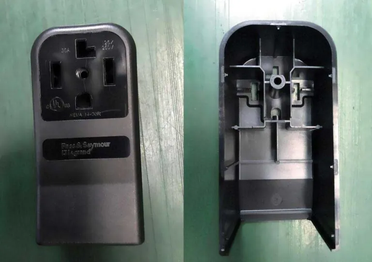

Beijing City Injection Molding of Legrand Socket Covers Using The CJ150M3V Injection Molding Machine
Legrand Socket Enclosures Our customer in Beijing City, China, has been employing 20 of our CJ150M3V Injection Molding Machines reliably since 2002 to manufacture socket covers in PVC for the world-famous Legrand brand. Filling 2 cavities with a shot weight of 134g each and thickness of 3.5mm the CJ150M3V Injection Molding Machine achieves a cycle […]

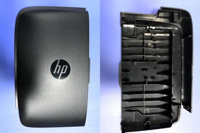

Hewlett Packard Printer Covers Manufactured Using the JM488-C2-SVP/2 Injection Molding Machine
HP Printer Covers In Chongqing City, China, our customer has been using 70 of our JM650-C2-SVP/2 Injection Molding Machines since 2012 to manufacture printer covers for world leading electronics manufacturer Hewlett Packard. For this Tier 1 application, the JM650-C2-SVP/2 Injection Molding Machine is driven by the SVP/2 Servo-Drive with a Nippobatta Ai-12 controller and delivers […]

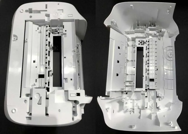

Injection Molding of Hewlett Packard Printer Bodies in Chongqing City
Hp Printer Bodies For this Tier 1 application, the JM650-C2-SVP/2 Injection Molding Machine is driven by the SVP/2 Servo-Drive with a Nippobatta Ai-12 controller and delivers a clamping force of 650 tons for extreme accuracy. Filling 2 cavities with a shot weight of 620g each and thickness of 2mm, a cycle time of 57s is […]
