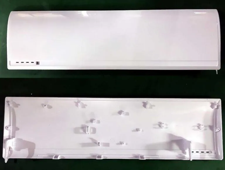

High Gloss Injection Molding of Air Conditioner Covers
Air Conditioner Covers When a customer in Foshan, Guangdong Province, China, was looking for the ideal Injection Molding system for manufacture of high gloss HIPS resin air conditioner covers, the decision to utilise our JM488-SVP/3 Toggle Type Injection Molding machine with High Gloss capabilities was an easy one. Powered by the SVP/3 Servo Drive and […]

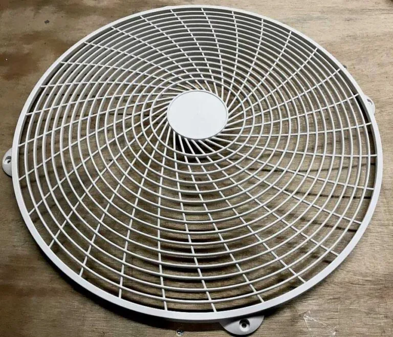

Fan Guard Cover Manufacture With The EM400-SVP/3 Injection Molding Machine
Fan Guard Covers Since 2016, one of our customers in Foshan, Guangdong Province, China, has been manufacturing polypropylene (PP) fan guard covers, employing 30 of our EM400-SVP/3 Toggle Type Injection Molding machines in this service. Applying a clamping force of 400 tones via an SVP/3 Servo Drive power pack controlled by the Nippobatta Ai-02, the […]

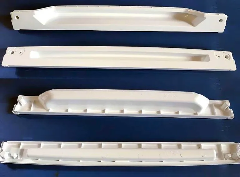

Injection Molding of Refrigerator Door Handles in ABS
Refrigerator Door Handles In Foshan, Guangdong Province, China, our customer has been employing 35 of our EM400-SVP/3+ Injection Molding machines to manufacture lower and upper handles for refrigerators in ABS since 2016. Filling 2 cavities with shot weights of 173g and 200g, and thickness of 2mm, the EM400-SVP/3+ Toggle Type Injection Molding machines are equipped […]

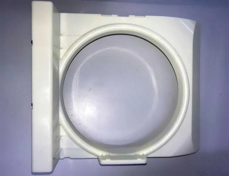

Injection Molding of Water Tank Parts in ABS Plastic
Drinking Fountain Water Tank In China, a customer in Foshan, Guangdong Province, has been using our MK6 Toggle Type Injection Molding machines to manufacture drinking water fountain water tanks in ABS plastic. Each injection molding machine applies a clamping force of 1000 tons, driven by the mk6 servo technology  and controlled by a MPC7.0 unit. […]

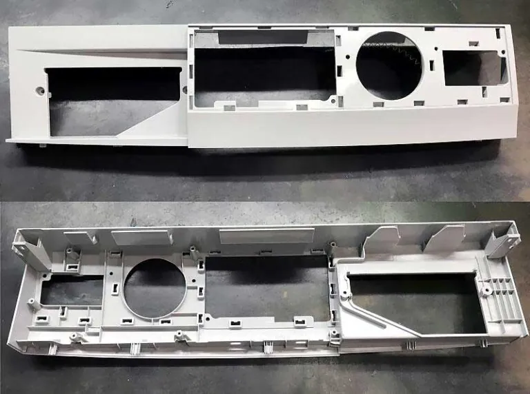

Injection molding Washing Machine Front Covers with the EM320-V Injection Molding Machine
Washing Machine Front Covers Our customer in Foshan, Guangdong Province, China, has been employing 8 of our EM320-V Injection Molding Machines since 2010 to manufacture washing machine front covers in ABS. Each part has a shot weight of 349g and a thickness of 2.5mm. In this application, the EM320-V Toggle Type Injection Molding Machine has […]
