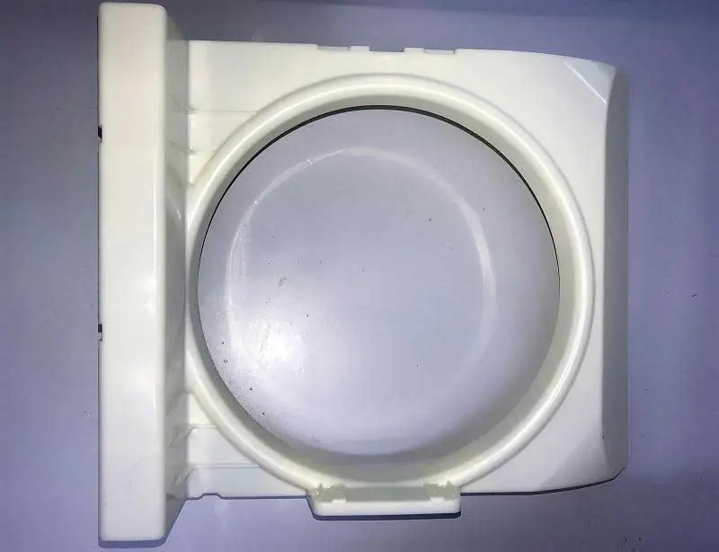

The EM560-V Toggle Type Injection Molding Machine has been proving its worth for our customer in Foshan, Guangdong Province since 2010 in manufacture of ABS air conditioner back covers.
The customer employs 40 EM560-V Injection Molding Machines with a clamping force of 560 tons driven by a VDP power pack and controlled by the Nippobatta Ai-01 system. Each product has a shot weight of 483g and a thickness of 3mm, manufactured with a cycle time of 43s in semi-automatic mode.
    EM560-V
  • Type: Toggle
  • Year: 2010
  • Clamping Force: 560 tons
  • Power Pack: VDP
  • Controller: Nippobatta Ai-01
  • Number of Machines: 40
  • Part: Air Conditioner Outdoor Unit Covers
  • Resin: ABS
  • Dimensions: 412mm x 340mm x 175mm
  • Product weight: 483g
  • Thickness: 3mm
  • Cycle Time: 43 sec.
  • Op Mode: Semi-automatic
