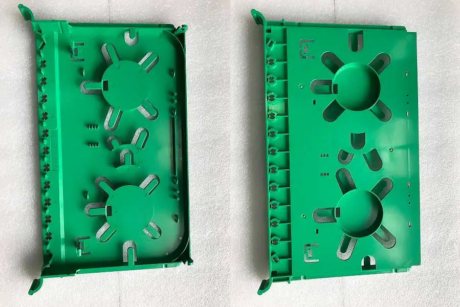

In Hubei Province, China, our customer has been employing 6 of our EM220-SVP/2 Injection Molding Machines to manufacture fuse box enclosures since 2012. Manufactured from ABS and polycarbonate (PC), each enclosure has a shot weight of 73g and a thickness of 3mm.
The EM220-SVP/2 is powered by an SVP/2 Servo Drive and controlled by a Nippobatta Ai-02, with a clamping force of 220 tons and a cycle time of 27s in fully automatic mode.
Electronics Fuse Box Enclosures produced by ChenHsong EM220-SVP/2 Injection Molding Machine
    EM220-SVP/2
  • Type: Toggle
  • Year: 2012
  • Clamping Force: 220 tons
  • Location: Hubei Province
  • Number of Machines: 6
  • Part: Electronics Fuse Box Enclosures
  • Resin: ABS + PC
  • Dimensions: 325mm x 195m x 25mm
  • Product weight: 73g each
  • Thickness: 3mm
  • Cycle Time: 27 sec.
  • Op Mode: Fully Automatic
