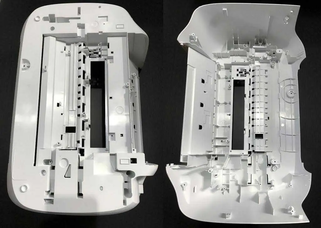

For this Tier 1 application, the JM650-C2-SVP/2 Injection Molding Machine is driven by the SVP/2 Servo-Drive with a Nippobatta Ai-12 controller and delivers a clamping force of 650 tons for extreme accuracy. Filling 2 cavities with a shot weight of 620g each and thickness of 2mm, a cycle time of 57s is achieved in fully automatic mode using High Impact Polystyrene (HIPS).
In Chongqing City, China, our customer has been using 70 of our JM650-C2-SVP/2 Injection Molding Machines since 2012 to manufacture printer bodies for world leading electronics manufacturer Hewlett Packard.
