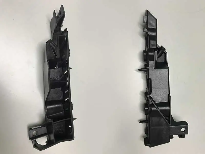

Speed, efficiency, and quality; all these are attained with the EM320-SVP/2 plastic injection molding machine. 10 of these machines are bringing great satisfaction to our valued client who is manufacturing automotive components in the High-tech Industrial Development Zone of Changchun.
The final part has a wall thickness of 4 mm, dimensions 230x40x83 mm left and right upper brackets. With a 63 gram shot of PP + GF20 plastic, under semi-automatic operation mode, these two brackets are produced in an exceptionally short cycle time of just 45 seconds.
The EM320-SVP/2 injection molding machine is operating at 320 tons of clamping force, and with the Ai 02 controller this makes high volume production an easy task for our client in the automotive industry.
Automotive components - left and right upper brackets are produced by EM320-SVP/2 Injection Molding Machine
    EM320-SVP/2
  • Type: High-Speed Toggle
  • Year: 2015
  • Clamping Force: 320 tons
  • Power Pack: SVP/2+ Servo Drive
  • Controller: Ai-02
  • Country: China
  • Location: Changchun
  • Number of Machines: 10
  • Part: left and right upper brackets
  • Resin: PP + GF20
  • Cavities: 2
  • Dimensions: 230mm X 40mm X 83mm
  • Product weight: 63 grams each
  • Thickness: 4mm
  • Cycle Time: 45 seconds
  • Op Mode: Semi-automatic
