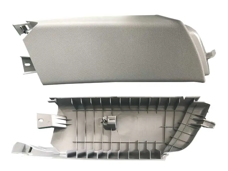

Production of two 428x126x83 mm decorative panels on C-pillar with a wall thickness of 2.5mm, using 241.4 grams of PP plastic per shot in each of its two cavities, is completed with each 63 second cycle. Operation mode is semi-automatic.

  • Part: Decorative Panel on C-pillar
  • Resin: PP
  • Cavities: 2
  • Dimensions: 428mm X 126mm X 83mm
  • Product weight: 241.2 grams each
  • Thickness: 2.5mm
  • Cycle Time: 63 seconds
  • Op Mode: Semi-automatic
