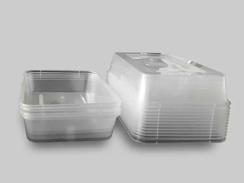

In Shunde, China, one of our customers is employing our Speed Pack 400 injection molding machines to manufacture food grade lunch boxes made out of PP resin with a shot weight of 17g. The containers are transparent and an inner size of 500ml.
The SPEED PACK thin-walled high-speed injection molding machine from the Chen Hsong Group is aseries of small-to-medium-tonnage hydraulic injection molding machines which stands for high-speed, high-performance & high precision!
The Speed Pack 400 driven in fully automatic mode and controlled by a Nippobatta CPC 6.0 achieves a clamping force of 400 tons and a cycle time of 7.1s in fully-automatic mode.
injected molded plastic food containers with lid - 500ml
