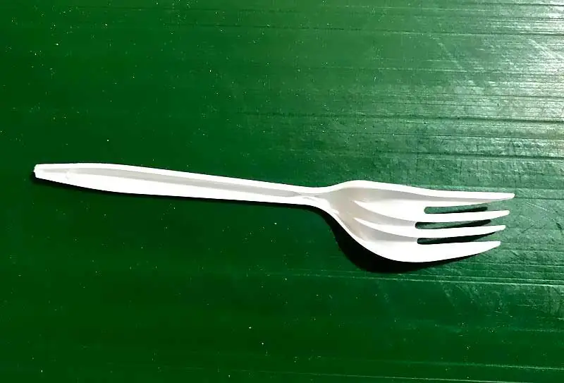

In Zhejiang Province, China, a customer has been employing 20 of our EM260-SVP/2 Toggle Type Injection Molding machines since 2016 to manufacture disposable forks in polypropylene (PP) in 36 cavities with a shot weight of 2.5g each and thickness of 1mm.
In fully automatic mode, the EM260-SVP/2 Injection Molding machine is powered by the SVP/2 Servo Drive and Nippobatta Ai-12 Controller, achieving a clamping force of 260 tons and cycle time of only 12s.
Disposable Forks with Automatic Packaging produced by ChenHsong EM260-SVP/2 Injection Molding Machine
    EM260-SVP/2
  • Type: Toggle
  • Year: 2016
  • Clamping Force: 260 tons
  • Location: Zhejiang Province
  • Number of Machines: 20
  • Part: Disposable Forks
  • Resin: PP
  • Cavities: 36
  • Dimensions: 148mm x 25mm x 20mm
  • Product weight: 2.5g each
  • Thickness: 1mm
  • Cycle Time: 12 sec.
  • Op Mode: Fully-automatic
