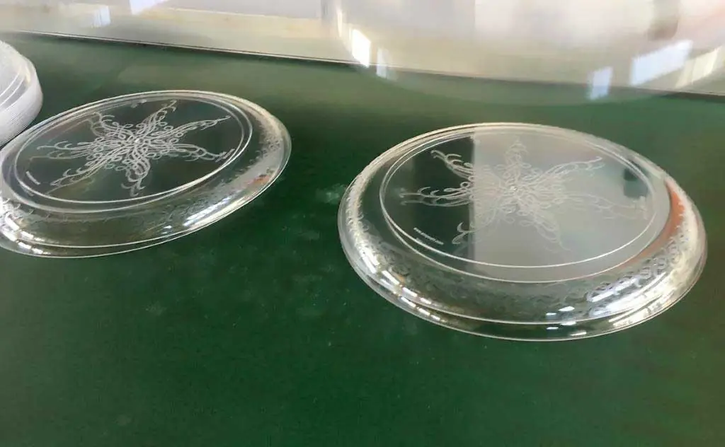

For disposable plate manufacture cycle time is an important consideration for mass production. This is why our customer in Taizhou, Zhejiang Province, China, chose our SPEED258 High-Speed Toggle-Type Injection Molding machine, driven by the SVP/3 Servo-Drive and Nippobatta CPC 6.0 controller to maximize output.
With more than 40 machines in continuous production since 2016, the SPEED258 Injection Molding machine delivers a cycle time of only 10s in fully-automatic mode, filling 2 cavities under a clamping force of 258 tons, with a shot weight of 70g per item in polystyrene, and a thickness of 0.6mm
Disposable Plates Produced by ChenHsong SPEED258 Injection Molding Machine

  • Type: High-Speed Toggle
  • Year: 2016
  • Clamping Force: 258 tons
  • Controller: Nippobatta CPC 6.0
  • Location: Taizhou, Zhejiang Province
  • Number of Machines: 40+
  • Part: Disposable Plates
  • Resin: PS
  • Cavities: 2
  • Dimensions: 235mm Diameter
  • Product weight: 70g / item
  • Thickness: 0.6mm
  • Cycle Time: 10 sec.
  • Op Mode: Fully-automatic
