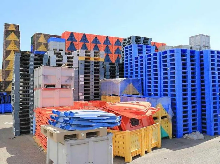

Industrial and logistics injection molding covers crates, pallets, water tanks, pipe fittings, valves, power tool housings, medical carts and sports equipment. Pallets and bulk containers are among the largest molded parts in regular production, which is why this category reaches the top of the Chen Hsong tonnage range at 6,500 tonnes.

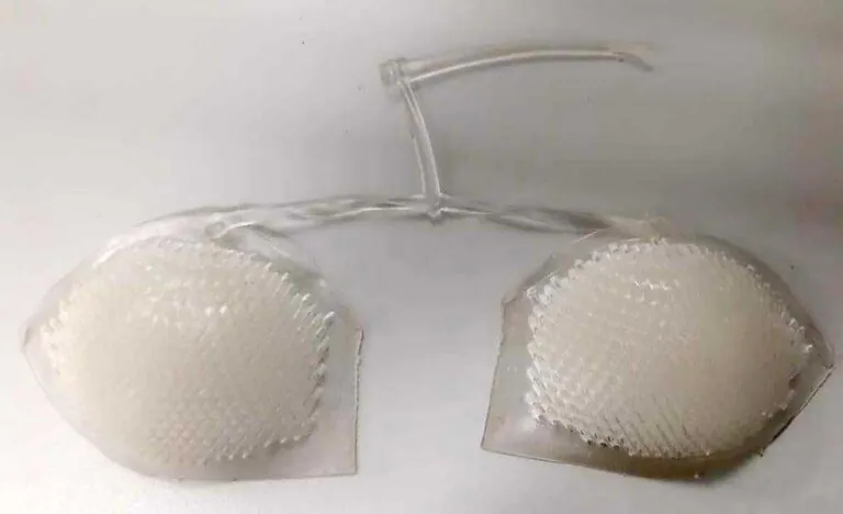

Bra Fillers The EM150-SVP/2 Injection Molding machine driven by the SVP/2 Servo-Drive and controlled by a Nippobatta Ai-02 is proving an excellent choice for our customer in Shantou, Guangdong Province who has been manufacturing bra fillers with this equipment since 2014, employing 17 of our injection molding systems. Molding in 2 cavities with EVS resin, […]

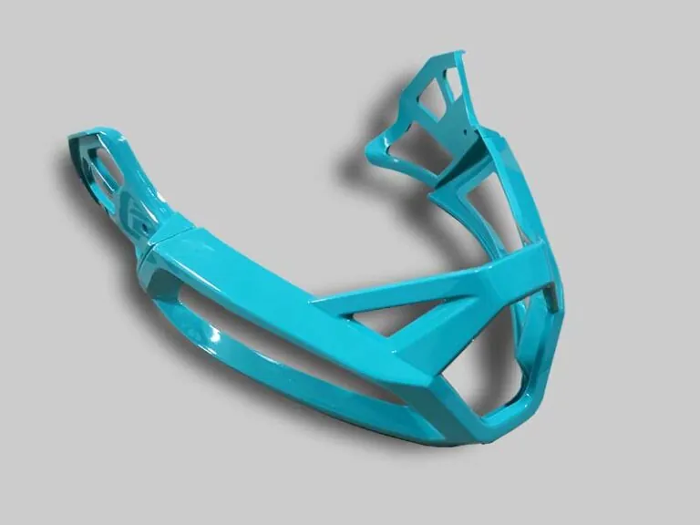

Cycling Helmet Component Polycarbonate plastic is one of the most common materials helmets are made from. It’s incredibly tough and lightweight and when it’s combined with a polystyrene liner, offers great impact resistance. In China, a customer in Jiangmen, has been using our MK6 Toggle Type Injection Molding machines to manufacture cycling helmet components in […]

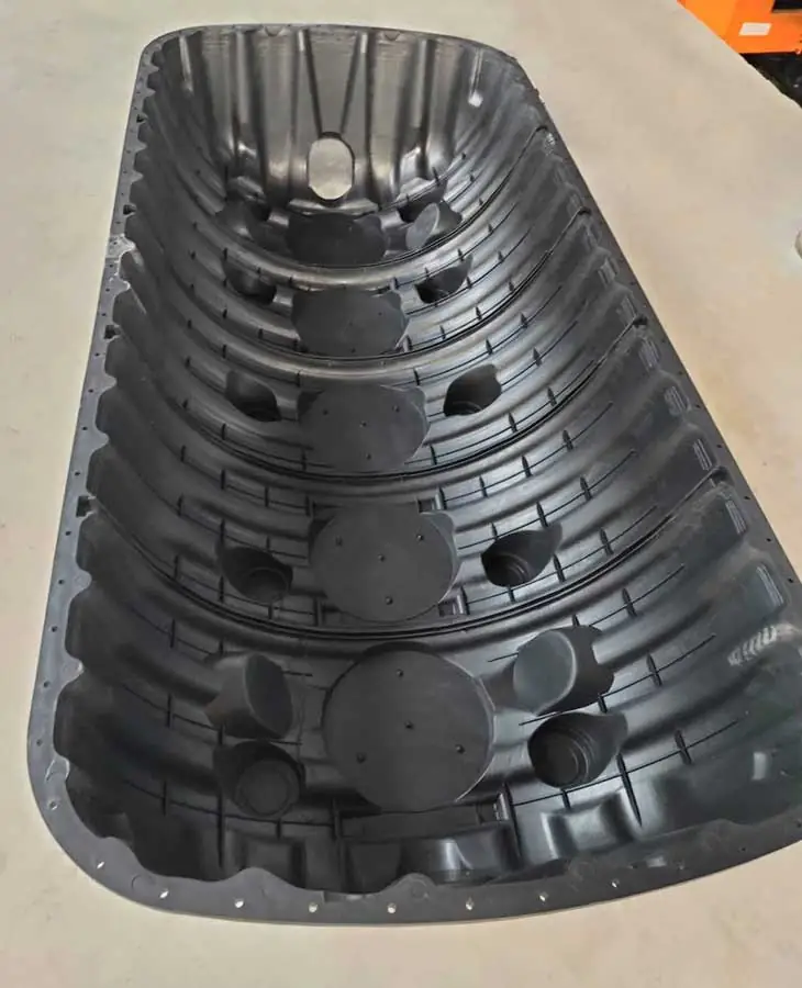

Plastic Septic Tank Chen Hsong’s large two-platen machine the Supermaster 3600 TP with custom modifications efficiently and accurately molds large septic tanks from polypropylene in a single color . In this project the injection molding machine is set to a clamping force of 3600 Tons. The MPC7.0 controller technology in combination with a specially-designed injection […]

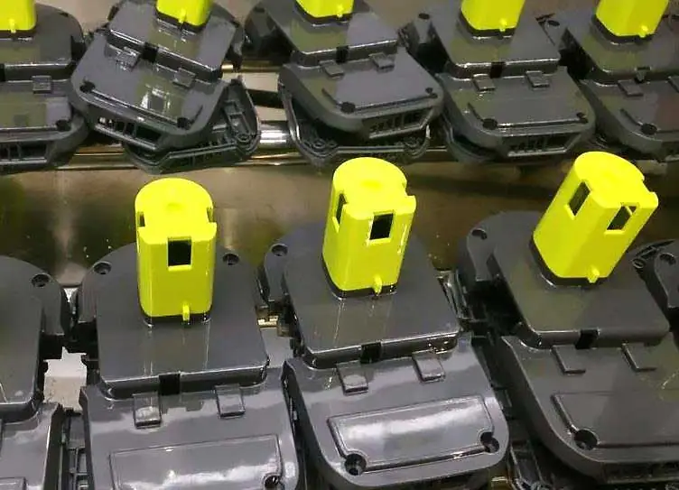

Power Tool Battery Casings with Dual Materials A very demanding Injection Molding application is manufacturing parts that require use of two different materials. In this example, our customer in Chiayi City, Taiwan, China, has been manufacturing dual material power tool casings in PA and GF since 2017. Employing 2 of our SM300DCV Toggle Dual-Material Type […]
