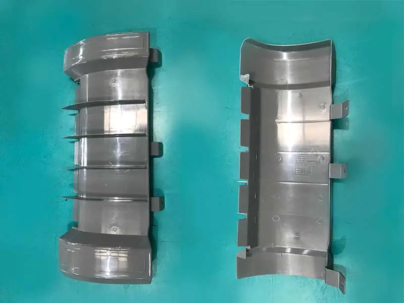

Left and right shroud inner plates
The High-tech Industrial Development Zone of Changchun is a main supply hub for components to the automotive industry. Chenhsong’s JM650-C3-SVP/2 plastic injection molding machines using an Ai 12 controller give our client the ability to provide turnkey solutions for there competitive market.
Ten of the JM650-C3-SVP/2 plastic injection molding machines are in operation at the Changchun Zone. Employing robotics in the production process, this fully automatic injection machine setup, operating at 650 tons of clamping force, is manufacturing left and right shroud inner plates in a cycle time of 51 seconds. Each shroud requires a shot weight of 680 grams of ABS and the size of the completed shroud is 640x270x120 mm with a thickness of 3mm.
Left and right shroud inner plates for automitive industry are produced by JM650-C3-SVP/2 Injection Molding Machine
