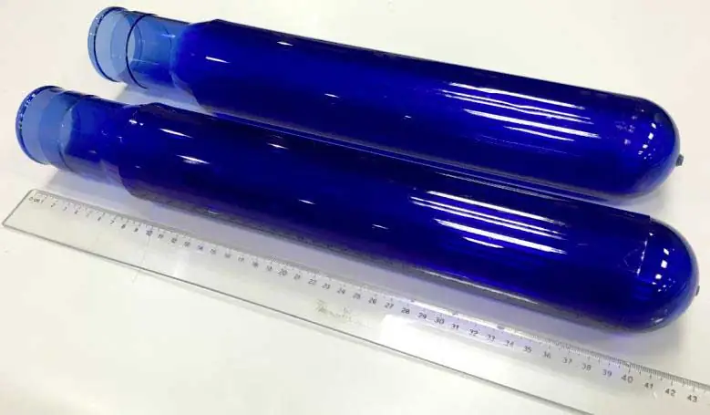

To manufacture large PET preforms for water containers, with a shot weight of 750g each and thickness of 8.1mm, our customer in Taizhou is employing more than 10 of our EM560-PET Toggle Type Injection Molding machines, with a clamping force of 560 tons driven by the SVP/3 Servo Drive and controlled by a Nippobatta CPC 6.0.
Operating since 2016, the customer is achieving a yield of over 99% in fully automatic mode with a cycle time of 118s. The EM560-PET Injection Molding machine features a professional plasticizing unit for thick, large preforms and guarantees low acetaldehyde levels for food-grade manufacture.
PET Preforms for Water Containers (Low AA) produced by EM560-PET Injection Molding Machine

  • Part: Large PET Preform for Water Container
  • Resin: PET
  • Cavities: 4
  • Dimensions: Length: 420mm
  • Product weight: 750g each
  • Thickness: 8.1mm
  • Cycle Time: 118 sec.
  • Yield: 99%+
  • Op Mode: Fully-automatic
