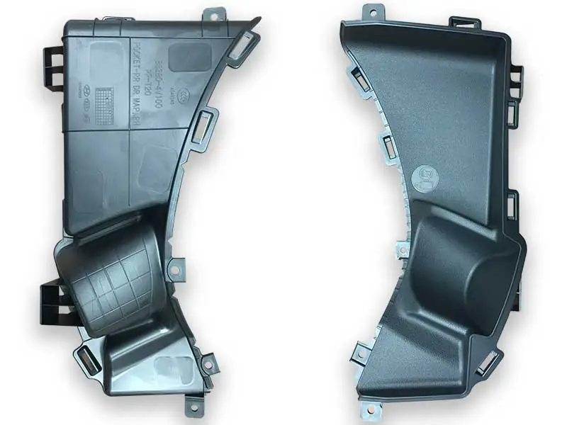

30 of our JM650-C3-SVP/2 Injection Molding Machines are working full-time in Shunyi District, Beijing to manufacture car rear door map pockets.
Operating in fully automatic mode, two rear door map pockets are completed in a cycle time of 35 seconds as a robotic arm offloads the parts, delivering high quality parts in time to meet the manufacturers strict deadlines.
The JM650-C3-SVP/2 is a High precision servo driven plastic injection molding machine, with up to 650 tons of clamping force. In this particular configuration the machine is filling 2 cavities with a shot weight of 211 grams each. The part is made of PP with a wall thickness requirement of 2mm.
Operating consistently since 2015, these 30 plus JM650-C3-SVP/2 Injection Molding Machines fitted with custom Nippobata Ai-12 controllers undergo regular maintenance by our Service team and are an invaluable asset in our customer’s manufacturing capabilities.

Number of Machines: 30
Part: Rear Door Map Pockets
Resin: PP
Cavities: 2
Dimensions: 415mm X 203mm X 89mm
Product weight: 211 grams each
Thickness: 2mm
Cycle Time: 35 seconds
Op Mode: Fully-automatic
