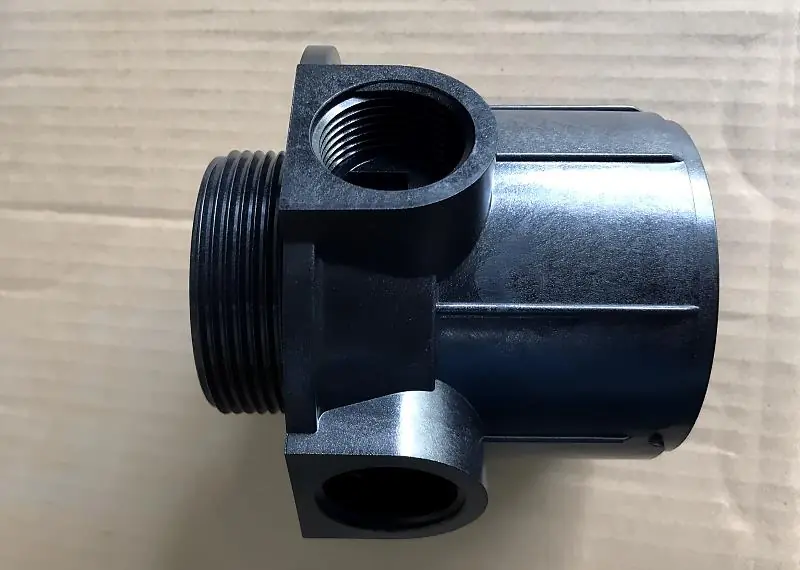

High performance products such as glass fiber (GF) ABS composite valve bodies require high performance machines, and this is why a customer in Zhejiang Province, China, chose to install 90 of our JM268-SVP/3 Toggle Type Injection Molding machines in 2015, to reliably produce very high volumes of these parts to exacting standards.
Applying a clamping force of 268 tons, powered by the SVP/3 Servo Drive and utilising a Nippobatta Ai-12 controller, the JM268-SVP/3 Injection Molding machine delivers a cycle time of 165 seconds with a shot weight of 364.1g and thickness of 7mm in semi-automatic mode.
Valve Bodies Produced by JM268-SVP/3 Injection Molding Machine

  • Type: Toggle
  • Year: 2015
  • Clamping Force: 268 tons
  • Location: Zhejiang Province
  • Number of Machines: 90
  • Part: Valve Body
  • Resin: ABS + 10% GF
  • Dimensions: 124mm diameter x 128mm
  • Product weight: 364.1g
  • Thickness: 7mm
  • Cycle Time: 165 sec.
  • Op Mode: Semi-automatic
