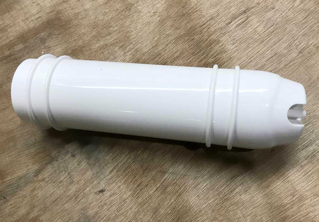

Exact manufacture and high levels of quality control are clearly achieved in the manufacture of injection molded water filters by our customer in Foshan, Guangdong Province. Since 2016, they have employed 30 of our JM650-C3-SVP/2 Toggle-Type Injection Molding machines, with a clamping force of 650 tons, driven by the SVP/2 Servo-Drive and Nippobatta Ai-12 control unit.
Filling 4 cavities, with individual shot weights of 210g and thickness of 3mm, our customer is able to achieve a fully-automatic cycle time of 90s in this high-performance application.
Water Filters produced by ChenHsong JM650-C3-SVP/2 Injection Molding Machine

  • Type: Toggle
  • Year: 2016
  • Clamping Force: 650 tons
  • Number of Machines: 30
  • Part: Water Filter
  • Resin: PP (Food-Grade)
  • Cavities: 4
  • Dimensions: 240mm x 70mm diameter
  • Product weight: 210g per item
  • Thickness: 3mm
  • Cycle Time: 90 sec.
  • Op Mode: Fully-automatic
