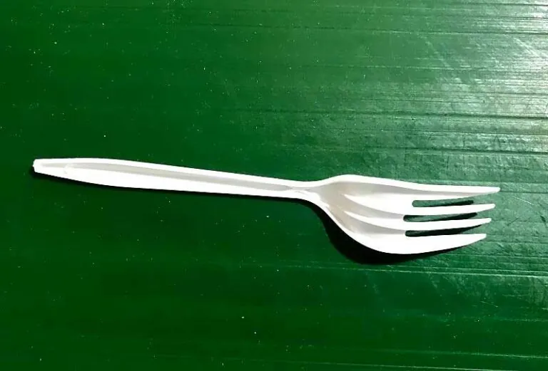

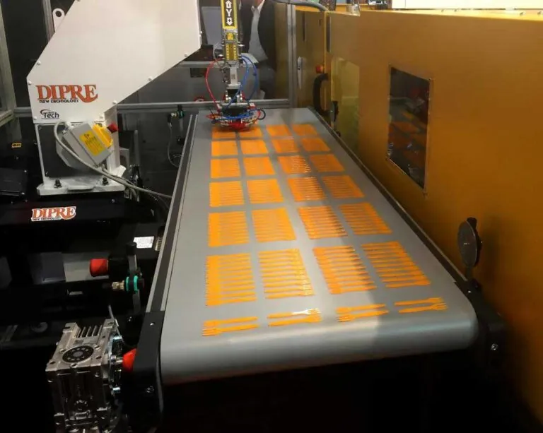

Disposable Fork Injection Molding with Automatic Packaging
Disposable Forks with Automatic Packaging In Zhejiang Province, China, a customer has been employing 20 of our EM260-SVP/2 Toggle Type Injection Molding machines since 2016 to manufacture disposable forks in polypropylene (PP) in 36 cavities with a shot weight of 2.5g each and thickness of 1mm. In fully automatic mode, the EM260-SVP/2 Injection Molding machine […]

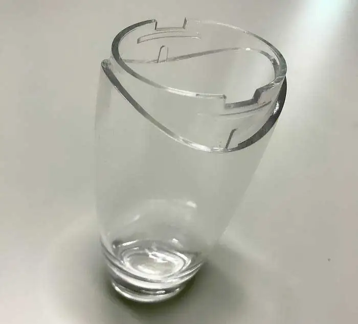

Cosmetic Packaging Injection Molding in Zhejiang Province, China
Cosmetic Packaging The EM180-SVP/2 Toggle-Type Injection Molding machine is proving its worth for a customer in Zhejiang Province, China. Employing 10 of our EM180-SVP/2 Injection Molding machines, driven by the SVP/2 Servo Drive and Nippobatta Ai-02 controller, our customer is manufacturing cosmetic packaging in PMMA, in 2 cavities with a shot weight of 83.9g each […]

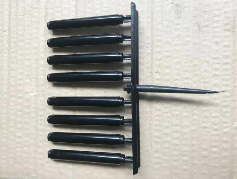

Injection Molding Eyebrow Pen Tubes in 8 Cavities with our EM150-SVP/3+ Machine
Eyebrow Pen Tubes In Zheijiang Province, China, a customer is employing more than 20 of our EM150-SVP/3+ Injection Molding Machines to manufacture ABS eyebrow pen tubes. The EM150-SVP/3+ Injection Molding Machine employs the SVP/3 Servo-Drive power pack, controlled by the Nippobatta Ai-02. Applying a clamping force of 150 tons, a cycle time of 37s is […]

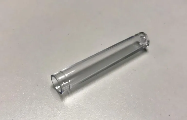

Eyebrow Pen Covers: 16 Cavities with the EM150-SVP/3+ Injection Molding Machine.
Eyebrow Pen Covers A customer in Zheijiang Province, China, is using more than 20 of our EM150-SVP/3+ Injection Molding Machines to manufacture polycarbonate eyebrow pen covers. With a clamping force of 150 tons, driven by the SVP/3 Servo-Drive with the Nippobatta Ai-02 Controller, our customer achieves a cycle time of 25s with a shot weight […]

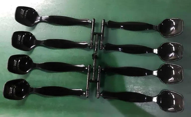

Manufacturing Disposable Spoons with The EM260-V Injection Molding Machine
Disposable Spoons In fully automatic mode, our EM260-V Toggle Type Injection Molding machine is producing disposable PP spoons in 8 cavities with a shot weight of 16g each at a thickness of 2mm and cycle time of 27s. Employing 20 injection molding machines and operating since 2009, our customer in Zhejiang Province, China, is using […]

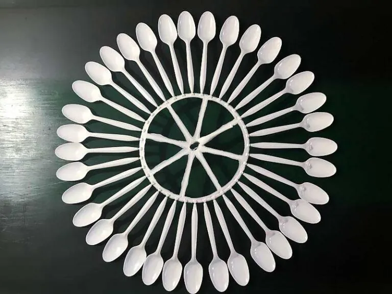

Injection Molding of Disposable Plastic Spoons
Disposable Plastic Spoons Fully Automated Solutions: Featuring a 9 second cycle time and clamping force of 268 tons, our JM 268-C2-SVP/2 Injection Molding Machines are enabling a customer in Zheijiang Province to run 20 Machines to mass produce disposable polypropylene plastic spoons each to a thickness of 1 mm in an entirely automatic process. Each […]

Demonstrating Injection Molding of Disposable Forks at MecSpe Parma Italy 2017
Disposable Forks Using our EM80 Euroseries Injection Molding machine, equipped with the SVP/2 Servo Drive and SmartMold88 controller, we demonstrated the versatility of our injection molding solutions in a 20 cavity application with a clamping force of 80 tons and the MecSpe event in Parma Italy. At this event we used the EM80 Euroseries Toggle […]

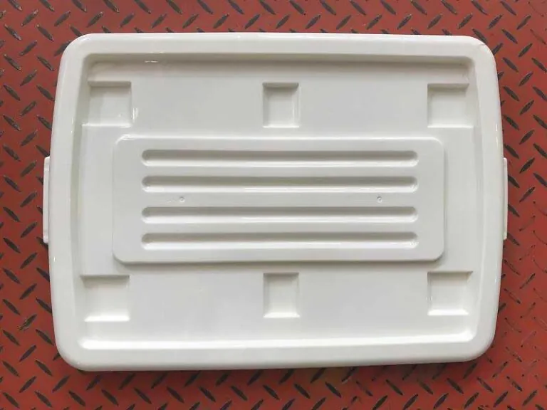

Container Box Lid Injection Molding in Polypropylene
Container Box Lids 15 of our EM320-SVP/3 Toggle Type Injection Molding Machines are currently in operation manufacturing polypropylene (PP) box lids in Zhejiang Province, China, where our customer is achieving a semi-automatic cycle time of 31s with a shot weight of 492g and product thickness of 2mm. The EM320-SVP/3 Injection Molding machine achieves a clamping […]
