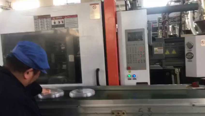

For disposable plate manufacture cycle time is an important consideration for mass production. This is why our customer in Taizhou, Zhejiang Province, China, chose our SPEED258 High-Speed Toggle-Type Injection Molding machine, driven by the SVP/3 Servo-Drive and Nippobatta CPC 6.0 controller to maximize output.
With more than 40 machines in continuous production since 2016, the SPEED258 Injection Molding machine delivers a cycle time of only 10s in fully-automatic mode, filling 2 cavities under a clamping force of 258 tons, with a shot weight of 70g per item in polystyrene, and a thickness of 0.6mm
Model: SPEED258
Type: High-Speed Toggle
Year: 2016
Clamping Force: 258 tons
Power Pack: SVP/3 Servo-Drive
Controller: Nippobatta CPC 6.0
Country: CHINA
Location: Taizhou, Zhejiang Province
Number of Machines: 40+
Part: Disposable Plates
Resin: PS
Cavities: 2
Dimensions: 235mm Diameter
Product weight: 70g / item
Thickness: 0.6mm
Cycle Time: 10 sec.
Op Mode: Fully-automatic
