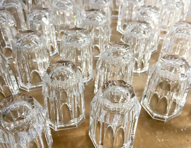

Cosmetic Containers Manufactured in PMMA With the EM180-V Injection Molding Machine
Cosmetic Containers In Zhejiang Province, China, a customer has been using 10 of our EM180-V Toggle Type Injection Molding machines to manufacture cosmetic containers in PMMA since 2017. Featuring the VDP Power Pack and controlled by the Nippobatta Ai-02, the EM180-V is configured with a clamping force of 180 tons in this application, filling 3 […]

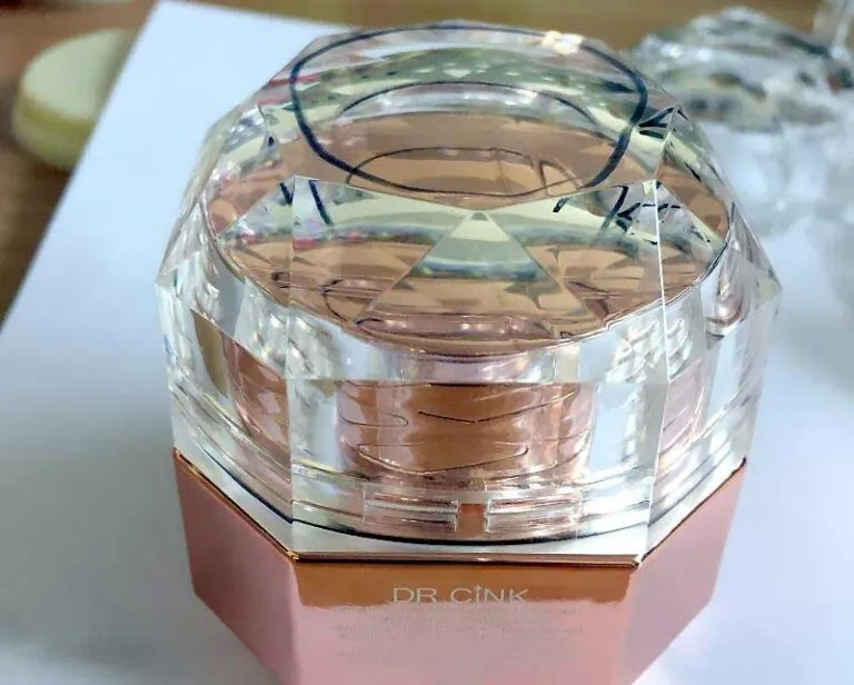

Fully Automatic Injection Molding of Acrylic Cosmetic Jar Lids in China
Cosmetic Jar Lids More than 40 of our EM180-V Injection Molding Machines are working full-time in Zhejiang Province to manufacture cosmetic jar lids. The EM180-V Injection Molding Machine is a toggle type with a clamping force of 180 tons, a VDP power pack and Nippobata Ai-02 controller. Filling 4 cavities with a shot weight of […]

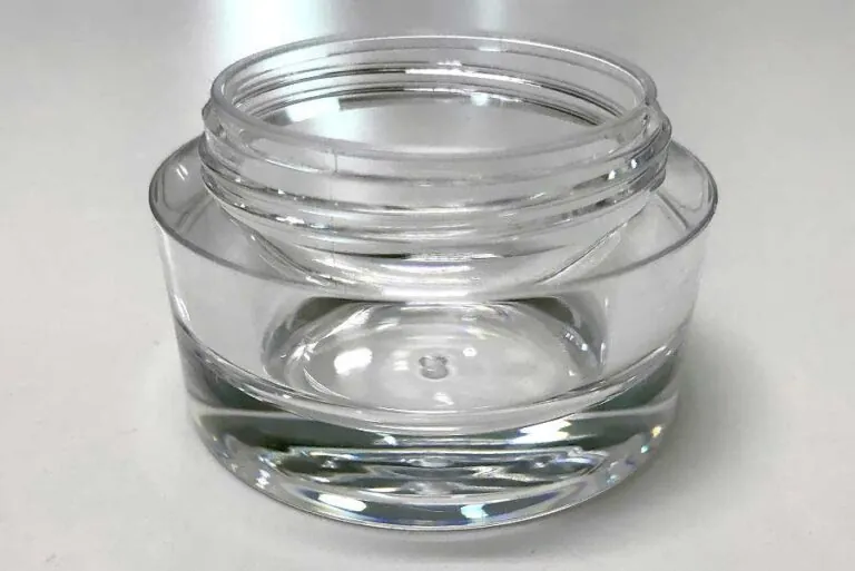

Four Cavity Injection Molding of Cosmetic Jars in Acrylic Resin
Cosmetic Jars Our customer in Ningbo, Zheijiang Province has been employing over 40 of our Toggle type EM180-V Injection Molding Machines since 2016 in fully-automatic mode, manufacturing cosmetic jars in MS (PMMA) resin in 4 cavities, with a shot weight of 35g each. The cycle time is only 60 seconds, with the injection molding Machine […]

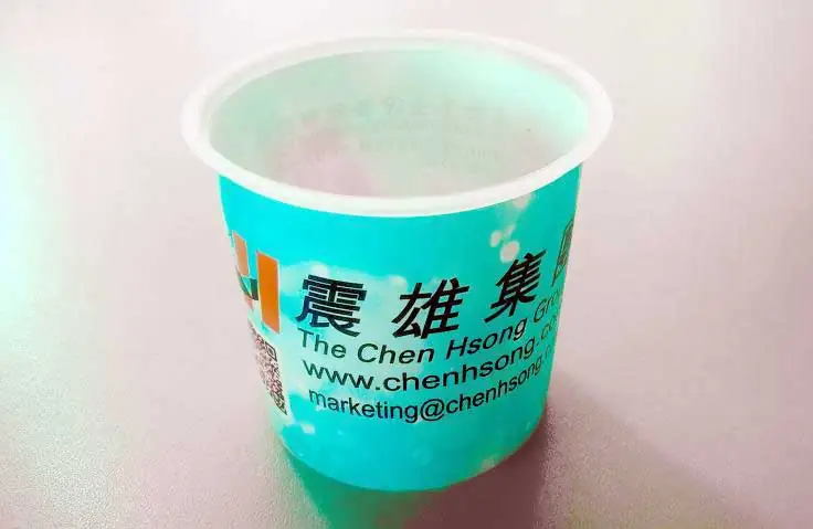

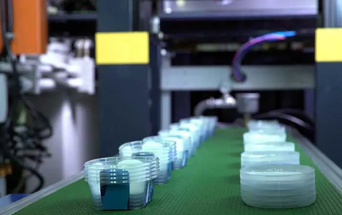

Fully Automatic Injection Molding of Disposable Plastic Containers with IML
Disposable Plastic Containers with IML The single cylinder injection model SM200TSV Injection Molding Machine is a high-speed toggle type with a clamping force of 200 tons. It features a closed loop servo valve and direct-drive plasticizing motor. Driven by a Delta Servo-Drive via a B&R SmartMold controller and PowerLink digital main bus it is capable […]

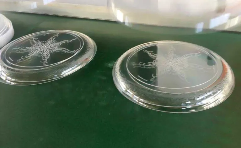

High-Speed Injection Molding of Disposable Plates in Zhejiang Province
Disposable Plates For disposable plate manufacture cycle time is an important consideration for mass production. This is why our customer in Taizhou, Zhejiang Province, China, chose our SPEED258 High-Speed Toggle-Type Injection Molding machine, driven by the SVP/3 Servo-Drive and Nippobatta CPC 6.0 controller to maximize output. With more than 40 machines in continuous production since […]
