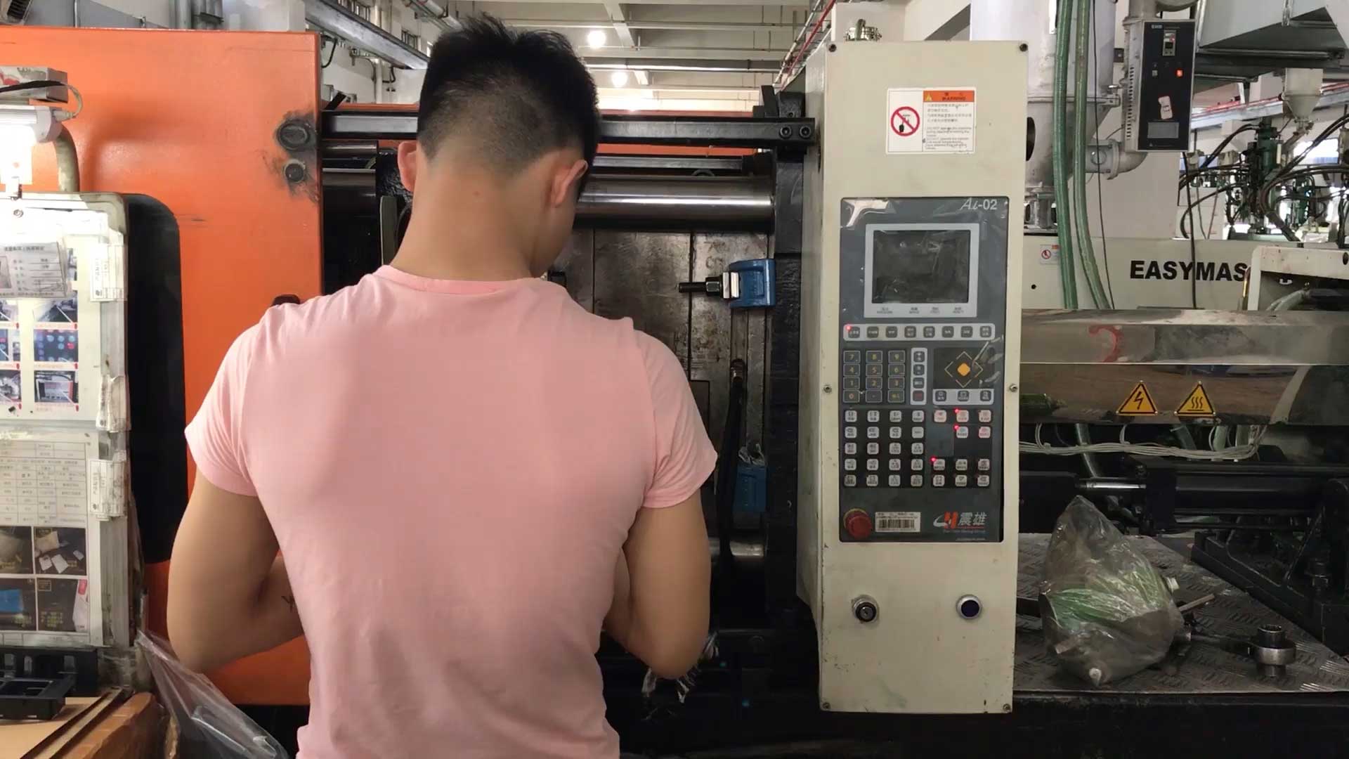

The intricacy of multi-surfaced components such as control panel car shields demands strict parameters during manufacturing to guarantee an absolute minimum of defects during production. The EM150-SVP/2 Plastic Injection Molding Machine with its Ai 02 controller and 150 ton clamping force gives the consistent quality expected in all its operations.
Over 50 machines are producing car shields in the Wenzhou Economic and Technological Development Zone. The EM150-SVP/2 machines are producing these 239x58x37 mm shields with a 1 mm thickness, injecting 48.9 g of ABS per shot. In semi-automatic operation mode smooth production is maintained with a 30 second cycle time.
Model: EM150-SVP/2
Type: High-Speed Toggle
Year: 2013
Clamping Force: 150 tons
Power Pack: SVP/2+ Servo Drive
Controller: Ai-02
Country: China
Location: Wenzhou
Number of Machines: 50
Part: Car Control Panel Shields
Resin: ABS
Cavities: 1
Dimensions: 239mm X 58mm X 37mm
Product weight: 48.9 grams each
Thickness: 1mm
Cycle Time: 30 seconds
Op Mode: Semi-automatic
