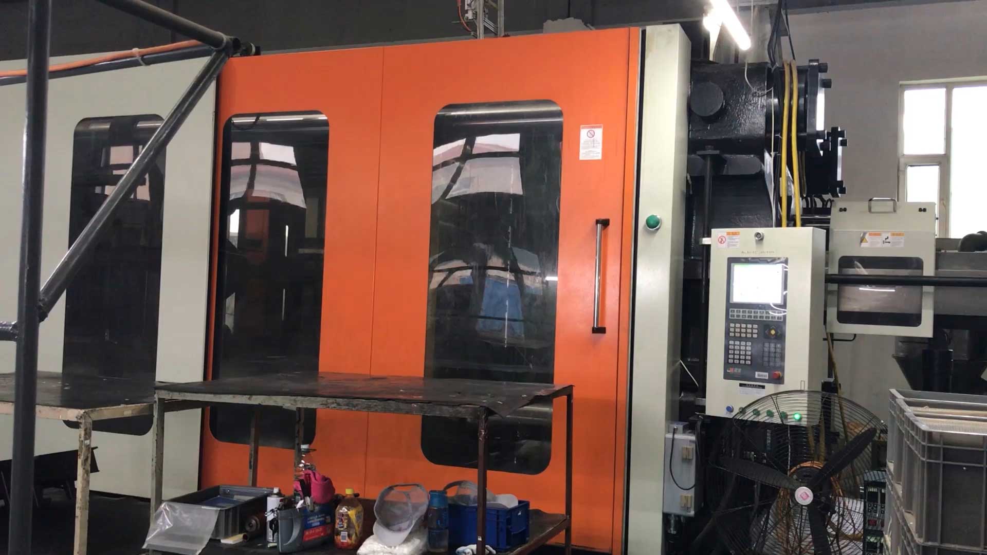

Meeting the ever-increasing demands of the industrial and automotive industry, our client in the High-tech Industrial Development Zone of Changchun is keeping ahead of the competition with the fully automatic JM-1400-C3-SVP/2 plastic injection molding machine series. 10 machines are producing these high-quality PP / PE plastic glove compartment storage boxes at the Changchun High-tech Industrial Development Zone.
Large volume orders are quickly filled with the JM-1400-C3-SVP/2 currently set at 1400 tons of clamping force and thanks to the machines reliability, mold wear and down time have been greatly reduced.
1090mm X 310mm X 220mm glove boxes with a wall thickness of 2mm are produced at a rate of one every 82 seconds. The shot weight is 2080 g and the machine is running in fully automatic mode with the AI-12 controller installed.
